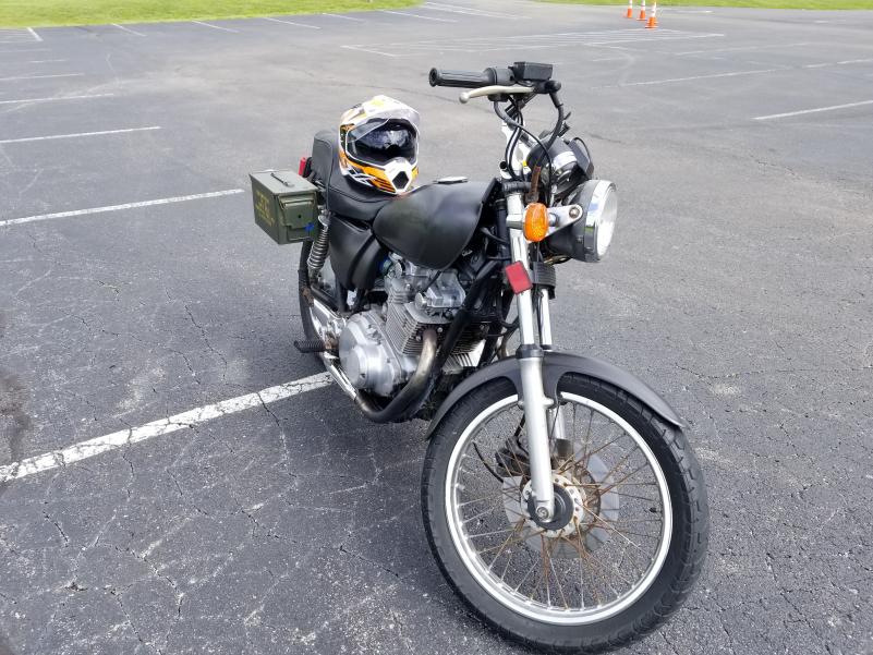

    Hey gang,
    Square in the middle of replacing my fork oil and I'm having one heck of a time determining what model GS450T I have! The manual shows a pretty big difference in oil amount between the TZ and the TXZ. The TZ will take 125mm and the TXZ will take 208mm.
    I would've just measured the amount that I drained out of each fork except there was hardly 2oz of jet black crude.
    (by the way, depressing those dumbass metal caps and digging out the metal ring that locks in the caps was a bitch doing it myself. I had to have my 70+ year old father with his "old man strength" come over and help
    I have the VIN of: JS1GL52A0C2102989
    I only have the old glue from the sticker opposite of where I found the VIN. I'll go look for an engine and frame number when I get back home this evening.
    Modifications from stock are as follows:
    Changed handlebars.
    No airbox.
    Changed mufflers.
    Here's a couple pictures if that'll help.

    Another pic

              Looks to me like you have the txz based on the fact you have wire wheels, the seat looks to be off an L. If your fork tubes don't have an air fitting at the top, it confirms that it is in fact a txz. The fork oil should be 143cc or 4.8oz. I'm 190lbs and pack about 100lbs of gear and am using 15w oil, seems to work just fine whether running loaded or unloaded. Last winter I put a 2" spacer in each leg to stiffen it up a bit which made a big difference in how it rides and handles.
