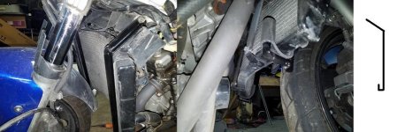

Got the new bearings and seals installed. It was creepy quite without the front wheel squealing every so often.
Removed the belly pan in preparation for the clutch/ oil pan. I wont have a day off until friday and I want to get her done in one night.
Something else I found out is my home made bike table is very sketchy with my 81 cr450 on it. I think I'm spoiled now that I haft to do everything stooped over this thing or sitting on a cooler. lol
Got the rest of the bike painted. I'm going to leave it as is until I can find a better headlight setup or the stock full fairing.
