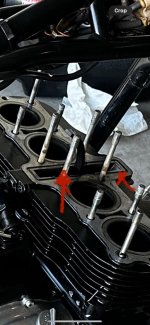

Only thing I can think of is the Aftermarket O ring around the timing chain opening is thicker and not allowing the cylinder head / head gasket to fully seat causing combustion to enter from the cylinders. Other orings in this set were thicker than oem.
