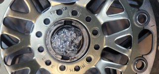

OK I'm in a quandary. The stock front disc's fit well on the hub but the cbr6 disc's have some slop. If I put the outside speedo drive trim ring (that which lies immediately under the disc locking plates gor nuts) above the salty monk spacers, it takes up the slop but I lose my 0.190" overhang. If i put the trim ring on the outside like the stock set up, then I'm relying on only the bolts to center the disc as the trim ring itself has some play on the hub. And stacking it this way it looks like I would only need to trim very little off the trim ring maybe 0.015". 20231014_165630.jpg
I assembled the wheel and rotor with trim ring outside and looks like the trim ring acts to stabilize the speedo drive so is 0.010" trimmed off about right ?
On your age of bike you may not need to trim that ring at all... The newer ones (80+) you need to trim about 3/16".
Yes it goes on the outside and yes the stock shoulder bolts act to center the rotor (that's why they are shoulder bolts). :)
