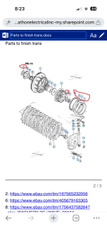

Most of the trans is torn down I had to order these parts I’m new to this so a lot of this is a first time experience I’m just maily concerned about knowing what gear it’s in when I go to put the trans back in IMG_5233.png
Well Caden, you got a lot to learn... That's a picture of the clutch, nothing there has a thing to do with the trans.
