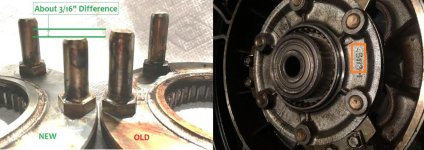

I just received the wheel side of the final drive today and I was wondering if the height difference (roughly .1875" or 3/16") from my old one compared to the one I received matters?
The part number that I purchased was 64680-45113 which apparently replaces 64680-45112 (originally on my bike). The only difference is the height because as you can see it fits perfectly in place and the spline line up as they should.
