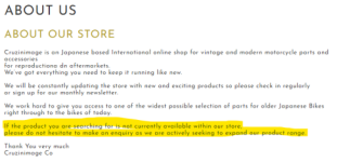

Email CruzinImage... they might make them for you..? Worth a shot. :rolleyes: I ordered the ones that just say "80-81 GS850" and they fit well on my GS850GL. They did match the part numbers from the parts fiche. All of mine were hard and shrunk.
https://www.cruzinimage.net/about-us/
