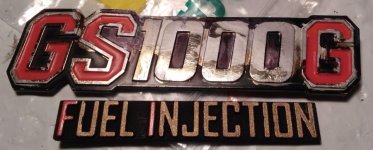

My second Shapeways order has arrived, and one of the items was a "Fuel Injection" emblem I designed. It came in black plastic, so I used a couple of paint markers (Orange & Metallic Gold) to mimic the side cover emblem appearance. The attached photo has a damaged emblem from my blue bike for reference. I'm going to see if I can rehab it.
