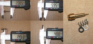

A while back a member was having trouble sourcing the Pilot screw for his BS32 carbs. I helped and we did searches and eventually a Pilot screw was found but was never really confirmed. Got some pics with dimensions from an ebay seller that seemed to be close................A drawing of the screw was made, by a GS member, (with dimensions), and shared with me.
I have an XS650 with BS34's and looking at Carb parts on the 650direct site I found 2 different pilot screws for the BS34 carbs the XS650 uses. I didn't/don't think the XS650 BS34's used 2 different profile Pilot screws.
I haven't tried these, but for the cost it would be cheap to try out. I do intend to buy a set for my bike but as it is in NZ and i wont get over there for another 2 months to be able to compare for a while
One of the screws looks exactly like the pilot screw for the GS650 BS32's...............Link to the page for the pilot screws
