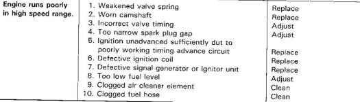

I was possibly incorrectly thinking coils ? would / could they produce this type of fault you think ?
