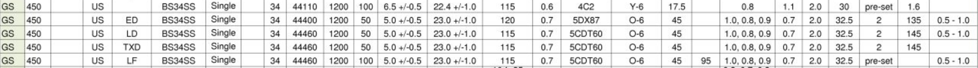

Still gotta do some more testing to be sure, but took it out for a 30 mile ride yesterday after setting the floats to 19mm and didn't have any issues.
