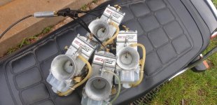

I could not do another day of the wiring stuff. I've started seeing rainbows. So rust treated and painted the frame and started on the aluminium. Its starting to come up a treat. I tested an Fe rust converter on the aluminium and it seemed to work instantly. Then hit it with cream of tartar paste to polish it. Tomorrow is harness day and general tidy up, then a bit of a touch up on the paint and then compression test and fuel delivery upgrade. I have a set of FBG 34mm Lectron flatslides for something a bit different. I like the factory carbs but at least one needle and seat is stuffed, choke is seized etc, and they have been sitting for years. And to rebuild the lot would be as cheap as buying a used set of FCRs.
