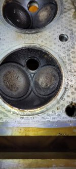

I have a 1979 GS550 that I've been working on and bringing back from about 8 years of not running and neglected. It's got about 22k on it. I've got it mostly running on 3 of the 4 cylinders. I did compression tests on all warm and cold, left to right is 120-120-70-120. It somewhat appears to run, but #3 is bad. I adjusted the shims, no change other than they are in spec now and sound better. I've ultrasonic the carbs, and adjusted the float heights. I did notice that the threads on #3 spark plug are not original and have been poorly fixed. Dumped some oil into the cylinder to check compression and test the #3 spark plug threads. Just as I thought, a mist of oil coming out around the plug or compression brass piece I had in at the time. This would explain the chuf-chuf I can hear and sometime feel around that plug (have to tighten the plug pretty hard to no feel it) Ideas?
Other than a new head, I was thinking I could braze aluminum around the threads and then touch it up for flatness so the plug will seal. This seems reasonable being machine shop time is expensive. A used head on ebay is around $120 but is always a gamble on weather its in spec or damaged.
For the sake of it, the most extreme option would be to do a head swap with a 1980 gs550 or 1983 gs650 I found near by online.
