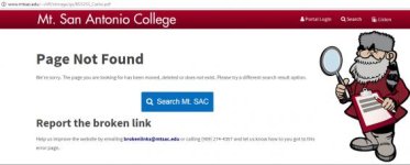

Basscliffs files seem to be hosted on a college website, which has since been deleted or moved.

I have chrome, the site works fine but I think half the files moved since I get this page...
It's just the links on mtsac.edu are down. But I would like another tear down guide of the dual carbs, the manual I found(for 550E) says I have Mikuni BSW30SS. But I couldn't find any stamp on my carbs without pulling them.
