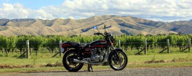

Started to clean off the Lanolin oil with WD40.
One half done ..........thought an afternoon photo was needed
