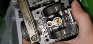

So, I'm taking another look at the carburetor. When I first disassembled it, all but one jet came out. Now, only one came out. The others are stuck, the heads shorn off.
Here is another one. Basically, there's nothing to grip to, on all of them.
I figured I might as well replace them anyway.
When you remove stuff like this, best first to hit with some penetrating oil...and wait. Then you need a screwdriver modified to fit the jet head completely by grinding back the screwdrivers shank - otherwise fun ensues . Since the jets came out before, they probably aren't stuck that bad. A left handed drill bit (about 3/4 the size of the jet's head) used carefully should bite into the jet and spin it out.
I agree with the left hand drill bit. Be careful, don't drill into the carb body. If the drill bit doesn't bite and cause the jet to spin out, you can take an appropriately sized torx head driver and lightly tap into the hole you drilled. You can also apply a little heat.
I think it might be a good idea to replace the jets, at least the pilot jets. What size are they? I tried looking up the parts in the service manual, but it lists "Pilot Jet #1" and "Pilot Jet #2," Yet I only see one jet under the rubber plug.

I’ll have to remember the Torx bit idea, but I have always used a left-hand drill to extract them.
Using the left-handed drill bit seems to just core out the jet, but it doesn't seem to loosen. Is that supposed to happen? This process seems more destructive.
The idea here is to hollow out the jet slowly and get the bit to bite into the remnant.
i trust that your bit is going counterclockwise??
A heat gun isn't enough. You need at least a propane torch, if not oxy-acetylene.

hey zombiepotatosalad, are you now working on the jet tube? Or still the stuck pilot jets? If the latter, how about a updated pic so we can view crime scene?

First thing: ungang the carbs. You can't use heat (nor rebuild) the carbs all assembled like they are. Since the gang plate screw(s) are stripped you are going to have to turn them out with a pair of vice grips or cut a slot.
Secondly, drill deeper using a smaller bit and work the bit sideways to be sure you are centered. If you are not centered you will ruin the carb body. The idea is to start with a small bit and step up in size until the shell of the jet spins out.
