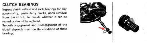

So do I open it up and put some grease on the part below with the red arrow? The clutch cable itself is brand new and there are no hard turns in the cable itself.

That would be the next step. Just try feeling the pivot of the shift lever externally before taking anything apart. It's the part of your shifter that's most rearward as bonanzadave describes if your shifter is set back and runs linkage forward. My bike is set up this way. It should feel free, maybe a bit loose.
So just so I'm clear I will take only the lever off and use grease (I have black ball bearing grease) on the area where the red arrow is pointing? So no need to take off the cover?
Not the clutch arm, the shift lever that your foot moves when you shift gears. Grease the shaft that the foot lever pivots on. It hasn't been asked yet, so I will. Do you notice high shifting effort if you shift without using the clutch?

Are you for real ?? That is a clutch arm. The shift lever, the piece you move with your left foot

The shifter lever is directly attached to the shaft. On the higher gears it's not as difficult to switch and as the bike warms up even the lower gears aren't as hard, but still pretty difficult. On top of that I can't ever get it to go into neutral when stopped unless I kill the bike and wiggle the shifter and then it will move. Maybe the clutch lever needs adjusted, I didn't follow any type of procedure. When I first was given the bike, before I replaced the cable, it had this same problem so it can't be the cable and I thought it wouldn't be the adjustment since it's been adjusted twice with two cable. So if you look at the attached picture am I putting grease on that area or opening the cover and putting grease on the shaft somewhere inside?
