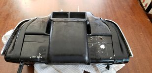

I'm going through an old GS850G and came across this; a plate riveted over the intake covering approximately half of it. I pulled it off, but cant figure out for the life of me why someone would do such a thing. Any ideas?
Do I need to get a new rubber intake snorkel? Or can I just run it through the hole on the back of the intake box?

I suspect that plate was trying to restrict the airflow (to create the vacuum needed to operate the diaphragm on the CV carbs) about the same as the snorkel would.
There is no way to "create the vacuum needed to operate the diaphragm"* by obstructing the intake. Somebody has attempted a bodge to fix the problem of a missing snorkel. You would be MUCH better off with a snorkel. The problem is that they are hard to find by themselves, without another airbox.
*That vacuum is created by air rushing through the venturi. If you block off the intake (to "create vacuum"), there won't be any air to rush through the venturi.
Yep, you gotta have the snorkel.
There's a strong chance (but I can't confirm... Steve may have some insight) that the shaftie snorkels are all the pretty much the same, so you may be able to scare up a ratty airbox with a snorkel from another GS shaftie and perform a transplant. Hard to say, since it's not listed as a separate part number.
In any case, if you could find a snorkel-adorned airbox from any other GS850 model, G or GL, any year, you should be able to transplant. If I faced this problem, I'd head downtown to ye olde motorbike boneyard and I bet I could scare up something pretty quick. You could also post in parts wanted; there are some folks parting out bikes. I don't know that a lot of shaftie airboxes get listed on fleaBay, but they are certainly available.
Back in the ignorant '80s, it was depressingly common for people to just remove airbox lids, snorkels, and such in search of increased airflow without bothering to do the requisite testing and rejetting. Or they'd interpret the resulting flat spots and leanness as increased performance somehow.

I can't see that as having much effect except at highest rpm...it looks like an attempt to enrich the engine. ..Air is compressible(but air compression is "work") so the effect is not simple (the stock airbox is also somewhat "restricted" comparing the surface area of the intake to the possible demands of the engine seen as an airpump...) ...At low rpm (and less air demand from the engine) it'd likely have no effect...all in all a bit like a dirty airfilter?
Besides restricting the intake to a specific size, the snorkel also directs the air inside the airbox to minimize turbulence. Having a rectangular opening with sharp edges is a somewhat ideal formula for turbulence.

Well fellas, this place saves another. This bike is a whole new machine, I cant believe it!
So I sealed the rivet holes and put on a snorkel and it made all the difference in the world, you all were right. Surging issues it had before are completely gone and it feels like it gained a bunch of power. Its so smooth now and pulls like a train. Fixing the intake on top of going through the valve shims (not a one would let me even fit a 0.04mm feeler gauge) and going through the carbs all using the BikeCliff guides have completely transformed this bike. Thanks again!!
