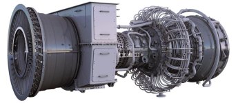

Shame on you for using reciprocating engines in power generation! LM6000 turbine powered power plant here!
We have the worlds first 3 hydrogen generators running traditional reciprocating engines. We only run our gens on alternative fuels... NatGas, biofuels, synthetic and hydrogen. We also have solar and heat pump divisions but nothing with wind as of yet. Probably coming though. Turbine gens aren't in our scope however, there is a turbine I sell parts too. Mostly safety items, no hard parts.
