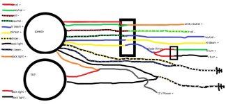

Installed speedo w/ dummy lights and tach from dime city cycles after the original gauges on my 82 gs450l cluster chonked. I computered this diagram to help me visualize the install. I put in a six-pin connector for the speedo wires as shown, a two-pin connector for the diode-thingy, and bullet connectors for the blinker & high beam grounds and power (the DCC tach came with bullets & I replaced the old ones in the harness).
All credit to Chuck78 for the heavy lifting on this as I used his figuring:
https://www.thegsresources.com/_for...(Dime-City-Cycles-mini-gauges-etc)&highlight=
the wires in my bike's loom were the same colors as Chuck78's, but check your wiring diagram. So far they are working well and looking shiny. Hope this helps someone!
