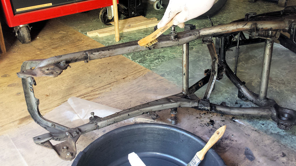

 So made the decision and headed down to Home Depot and got a gallon of sprayable paint stripper, a brass brush, and cheap paint brush for applying and removing the paint. The paint brush helps get the stripper in the nooks and crannies and the brass brush helps remove the stubborn paint without scratching the metal. A helpful hint - use latex gloves or you'll burn yourself! Don't bother using nitrile gloves, they will melt too! Take your time and the paint will come right off.
This stuff works great
 I now have most of the paint removed from the frame. When I get done all go over it and make sure that all the paint is removed from the crevices as well as any grease that may be around. Then I'll powerwash it once more to make sure that it's as clean as I can get it. Then I'll strip the rest of the parts.
Removing the paint from the frame

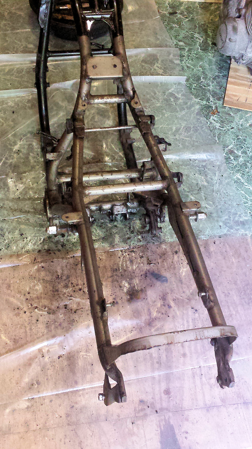

2/3's of the paint removed!
 At this point it looks like I will spray the frame and parts using a single stage urethane paint. I have concerns about about durability and paint gloss using a powdercoat paint. I feel the best results will come from a single stage paint.
