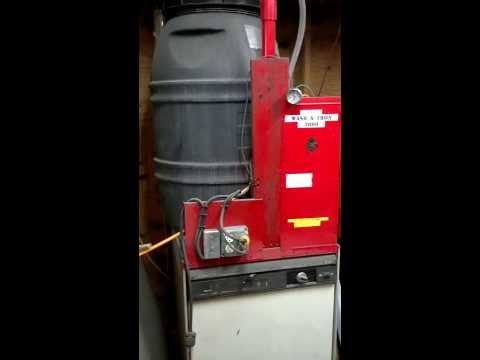

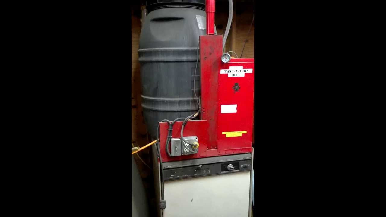

                                On the wrenching front; today was spent browsing various diy / homebrew parts washers and my eyes were opened at some of the ingenious and some downright dangerous contraptions that have been dreamt up.
                                One of the best was this one...
