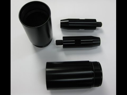

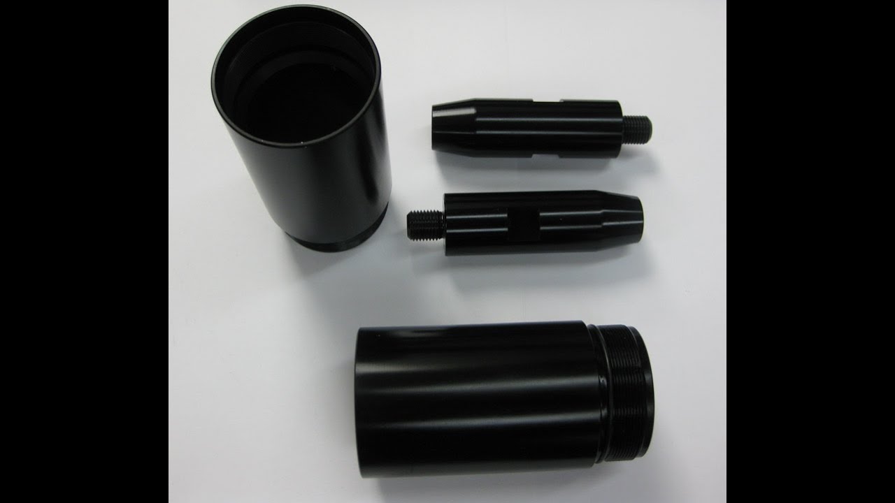

    Excellent work. Are the smaller pieces extensions for the dampener?

      Here is a good video that shows how these go together better than I can explain.
        #6348
        That's what I thought, but I'm not sure about the instructions of using the manufactures amount of oil. With the increase of volume inside the tube, the air gap will be larger than what the manufacture calls for. It's the air that compresses and with a larger volume of air the springier it's going to feel. With that said i would go by the manufactures air gap or oil level, how ever they say it. The Suzuki manual for the '03-04 GSX-R1000, has the oil capacity at 509ml and the oil level a 101ml. I'd go by the oil level.
          #6349
          I agree. It makes sense to me to use the stock level.

            Originally posted by Tripledij
            I am switching from stock forks and front wheel to 2004 gsxr1000 forks and 2006 gsxr600 wheels, both of which lower the front dramatically.
            I spent a fair amount of time searching this forum for info by anyone who had already done this. Threads like this were a big help.
            I want this bike to maintain a fairly stock geometry because I already have a sport bike, this is to be my comfy cruiser. In my opinion, this is too much of a height difference to make up by jacking up the back end.
            I am not a machinist by trade, but I did stay in a Holiday Inn Express last night. I do have a home machine shop and make/modify parts for work on occasion.
            Here is a different pic showing the lower extensions. Although you don't see it in the pic, there is an oil passageway all the way through those.
