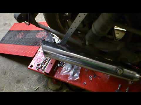

          Started the rebuilt 850 in earnest to see what the exhaust sounded like...
          The phone tends to pick up the treble more than anything and doesn't really give much of an idea what it sounds like. It's a fair bit bassier than this, without being loud.
          The alarming rattles are things bouncing around on the worktop, nothing terminal in the engine.

            #6815
            Does it sound like a Harley?
              • 5805
              #6816
              Oddly, it sounds a little more Harley-esque than the Motad did. Obviously not because there's a big twin thumping along, but some of the design aims of the Harley muffler team are still there, even without the full packing inside. There's an interesting growly bark that might show itself more when under load and higher rpm.
