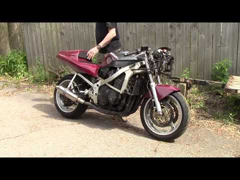

      Track Bike Runnin REEL GOOD
      Wasted a weekend on a front sprocket change that did not fit.
      I should have been road testing this bike. Time ran out.
      After putting the bike back TG, I did a warm up video.
        What type of top-triple is on this bike ?
