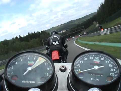

                        Some cool footage of a 3C at Spa, not sure the speeds as his speedo cable broke. Skip to about 6:30, couldn't make the link that starts at that point.

                          • 5806
                          Heh. Amusing how he just rode around the outside of the Seat Polisher @ 8:37
