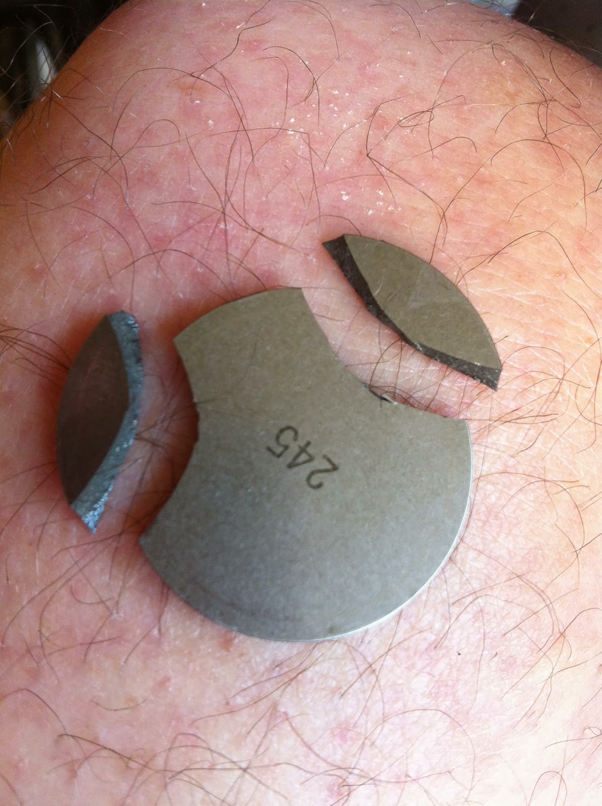

                Between you and me, I made another rookie mistake in that I turned the engine over with a shim not seated properly (in this same no. 1 cylinder but on the intake valve). The result was the shim was shattered but I was concerned there may have been other damage to the shim bucket or something else.

                    Between you and me, I made another rookie mistake ...
                    OK, I won't let anyone else see this.
                    ... that I turned the engine over with a shim not seated properly (in this same no. 1 cylinder but on the intake valve). The result was the shim was shattered but I was concerned there may have been other damage to the shim bucket or something else.
                    I had a shim shatter once, but it was because the tool slipped off the bucket and it slammed closed.
                    THAT is why I use the zip-tie method to hold the valves open to change shims.
                    Hopefully you got ALL the pieces of the broken shim. I fished around in the oil pools with a magnet for quite a while,
                    then spent some more time re-assembling the shim before I was comfortable that I had enough of it.
                    I laminated it with clear packing tape, it's now a little paperweight on my desk.

                      Steve - Mine was a pretty clean break. I think I got it all:
