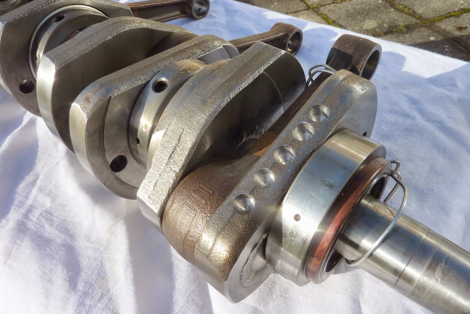

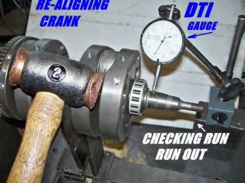

                                Crankshaft builder here in the UK replaced a main bearing, welded it all up and did a balancing for me. Still not back in the motor so I can't tell you what it's like. On my rideable GS1150, heavy bar end weights stop the fingers going numb - or just go at over 5,000 rpm - that seems to work.
                                Here is the balancing work:
                                Here's a bunch more pics: Crank
                                And this is how he does it:
