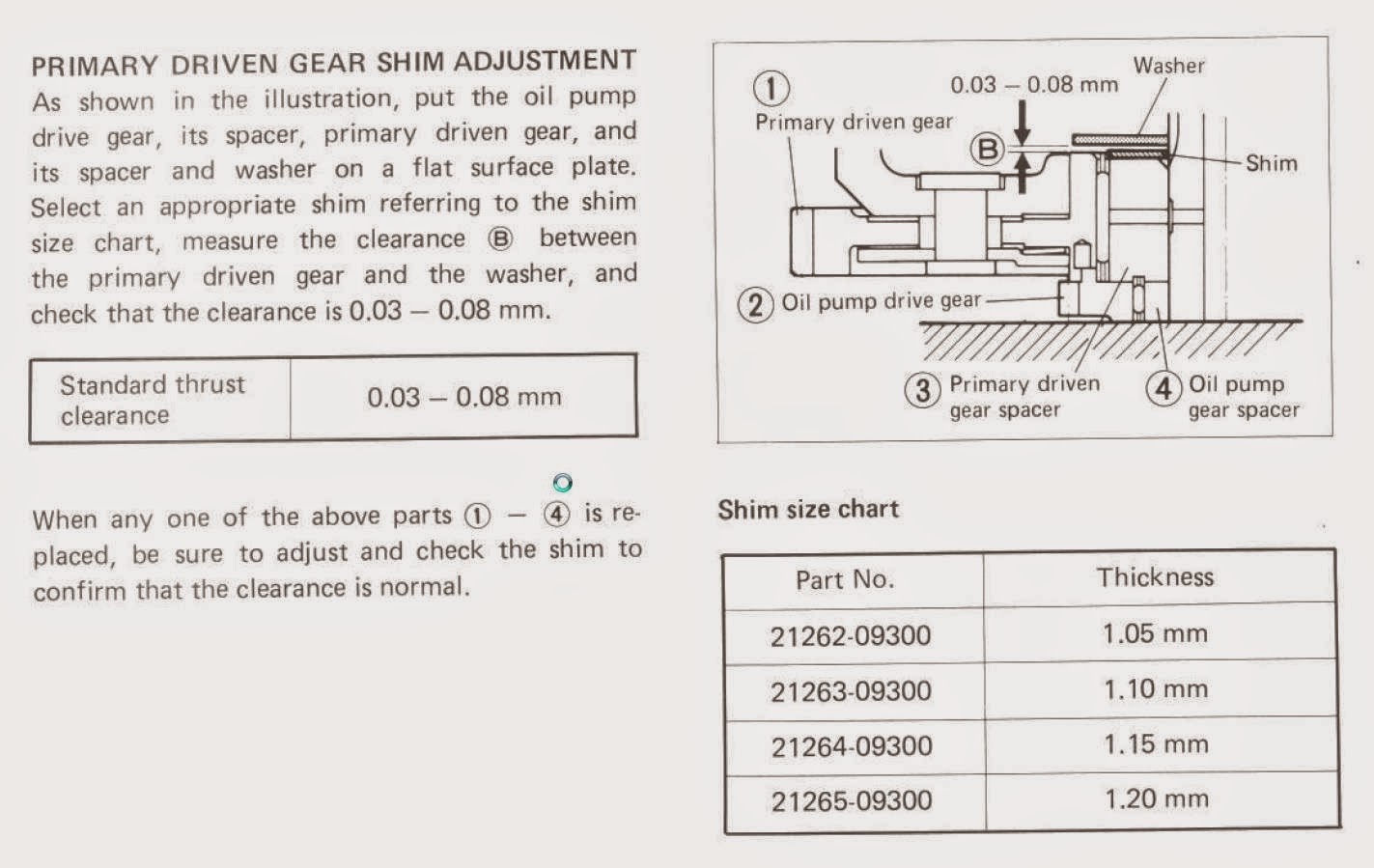

    Also, the fische shows 4 shims, i assume of different sizes (#4 on the fische). Should I get all 4 and use the one that fits best?
    The manual shows how to measure this, but i need to study it more to fully understand....

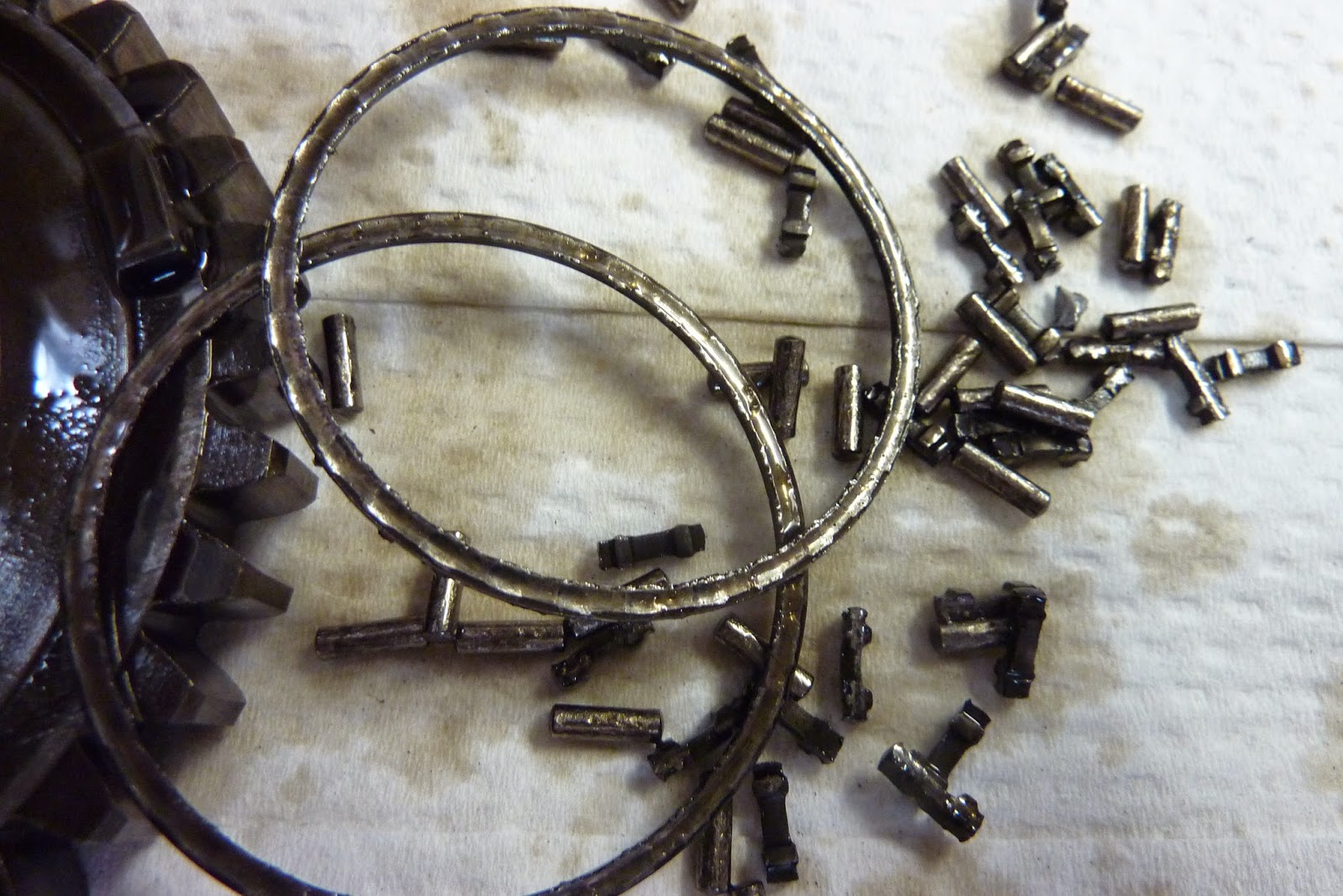

      Here is one where you can see a shot oil pump bearing:
      GS1150 Blog Engine
      and here are some pics from my other GS1150 engine:
      Looks like they are severely stresses most of the time and should be a standard replacement in any build.
      I have also suffered at the hands of that diagram about measuring the slack and adding the correct size washer:
      This took me a while to figure out. Just bench build the clutch. Put the oil pump drive gear and outer clutch hub down on a steel plate if possible. Then add the inner spacer, then the shim (you don't have) and the washer. The next bit is quite difficult. Get a feeler gauge between the shim and washer and measure the gap. If it's not within range check the chart and get the correct sized shim. These are still available from Suzuki. I got one a couple of months ago.
      Here's how you do the measurement of the shim: GS Shim Measurement Blog

          Heres what I found - I was hoping the shims on hand would work. No good. Max clearance spec is .08mm. With the closest shim I'm at around .1mm. Once confirmed that I was goofed, I began studying the parts on the bench in front of me. I noticed the clutch sleeve surface where the (loose) nut was shows wear marks. With that in mind I slid it onto the input shaft and found a whole lot of play in the splines.......double goofed.

                        Mine had some slight galling. I replaced it, and shimmed within the range stated in the manual.
