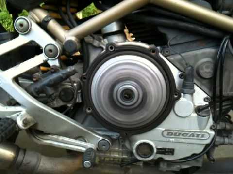

Have you ever heard one of those Ducatis with external dry clutches? Might make you feel a little better:
