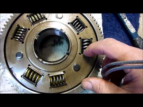

Clutch "chatter" can be one, a combination, or all of the following:
- incorrectly adjusted clutch
- loose clutch hub nut
- outer basket play on the gear box spline, especially if your basket has the steel insert like this one:
- rattling springs on the outer clutch backing plate (unlikely to be the rivets - you would be really in trouble if it was):
- little rubber "anti-chatter" bung missing or damaged like this:
- lateral play as a result of the clutch hub spacer being slightly wider than the clutch hub. This problem was sort of cured on the GSX1100 / GS1150 engines by using a variable width shim to take up the slack.
Just some of the reasons they ALL rattle. Here are some of my clutch rattle vidoes:
For a GS; if it ain't rattling, it ain't running.Richard
