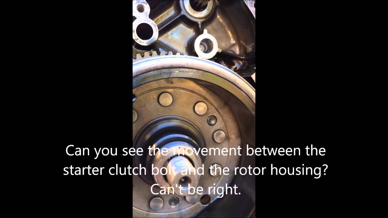

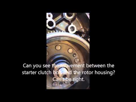

                        You are going to need to take the rotor off (it's a pig to do but plenty of threads on here will help) and check the assembly thoroughly. And there are 2 potential problems you may have here. This is one where the starter clutch bolts are loose and worn bigger holes in the rotor and stator was loose and all moving about. Watch the video until the end:
