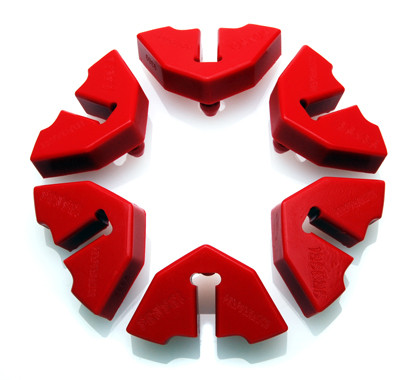

                taking the rear wheel apart to clean, I managed to break the nub off of one of the rubber wedges. Would this be a problem if I put it back this way? Suzuki calls it a SHOCK ABSORBER, REAR DRUM. $7.84 for 1 or all 6? PO typically will show how many are required of a part. This shows quantity of 1.
                If I order and get just one, will replacing just one have any adverse effects? If I order and get all 6, that’s fine but seems an unlikely price for all 6.
                your collective knowledge is appreciated.

                  Not sure about the pricing, but it would be fine to replace just one. Over here that would be called a cush drive - it takes up the shock when the sprocket carrier engages the rear wheel.

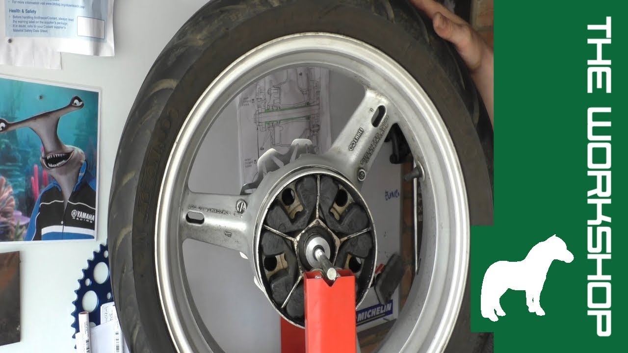

                      For anyone else, like me, who may have been completely ignorant of what the cush drive is, or does, here's a short video explanation. STONG LANGUAGE, but informative.

                        I replaced a set a year or two in and have had the same set since. Its a hell of a part used in practically all suzuki bikes up to Hayabusa same part same strength durability etc.
                        There are aftermarket ones made that the Hayabusa guys see, to like. Red polyurethane

                            All that little rubber tit does is hold the cushion in place during assembly. Almost useless cause when the driven hub is put in, the rubber cushions can't get out of place until hub is taken off again. Yeah, for $6 replace it, but if you don't, you'll never know the difference.
