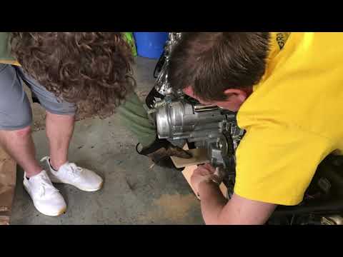

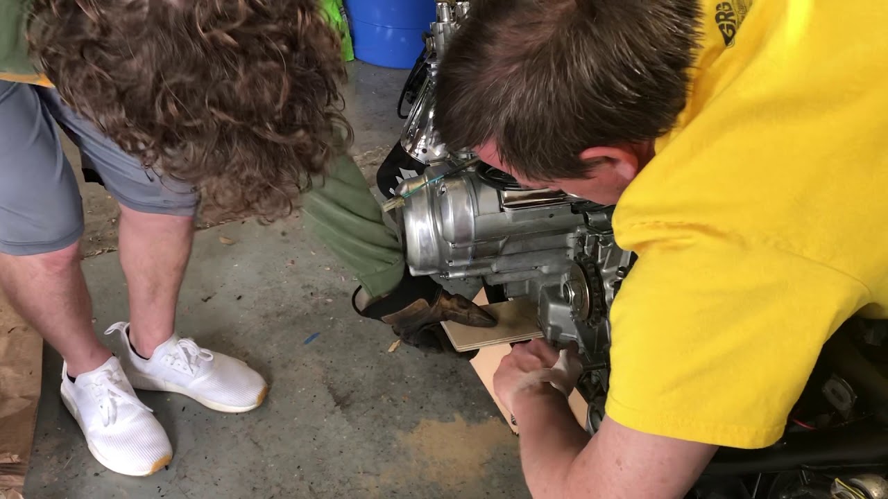

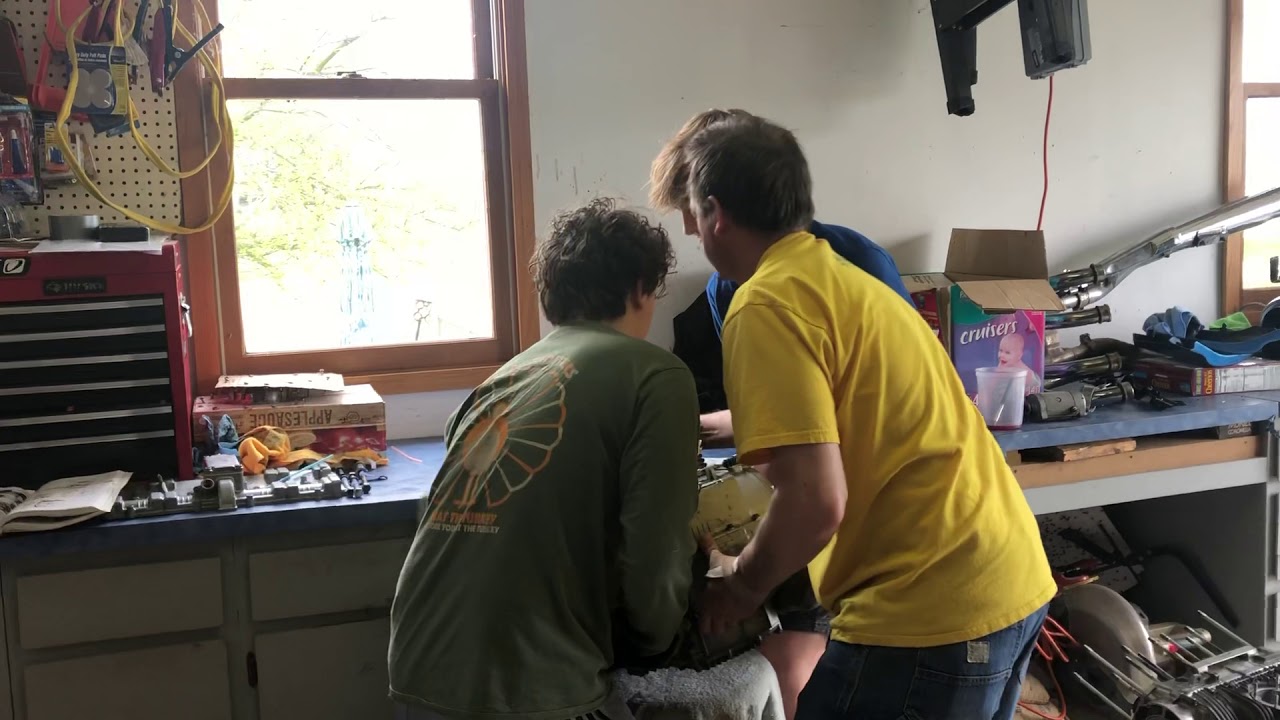

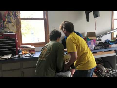

                I do feel good. And tired. I was up way too late last night putting the engine together and polishing case covers. Enjoying a well deserved beer.
                Here are a couple of videos of the engine install. Did scratch the new frame paint a bit. Should have tried to protect it. Oh well, live and learn. I’ve learned so much about this bike in the last 4 weeks. Never took and engine apart past the valve cover before. Never honed a cylinder before. Carb install seems to get easier every time you do it. But no matter how many times I’ve take the exhaust on and off, it’s always a PITA. Using The floor jack to lift the exhaust into place, I actually lifted and dumped the bike over onto the floor, luckily nothing damaged.
