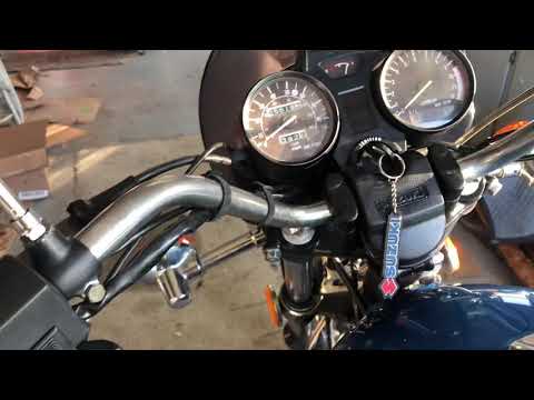

I’m going for a ride! Heres the first startup video. Ok. My wife interrupted the first one, my son interrupted the second one. This is the third try at a first start up video. Wondering about the self -returning choke thumb lever. It never did that before. Also wondering why my oil light might be one when running. I put exactly 4 qts of oil in. As far as I know I connected the sensor wire correctly. I’ll get on figuring that out later. IM GOING FOR A RIDE! .Rich
1982 GS 750TZ
2015 Triumph Tiger 1200
Awesome Rich!!! You are the man! The engine sounds great.
Yeah, check out that oil light situation. I thought I saw it blink once...Last edited by storm 64; 05-25-2020, 07:33 PM.My Motorcycles:
I sure hope the oil light is an electrical problem and that your ride goes / went well.. there's a pressure swith somewhere. Not sure where on the 750. Personally I'd sort that before riding it..
Choke lever has a screw on the bottom. Tighten it up a touch. .sigpic
