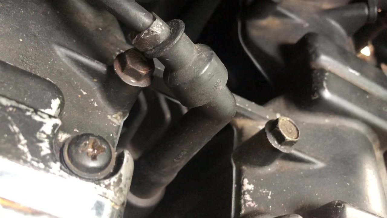

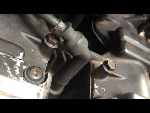

    Hey all,
    I've been wrenching a lot on my 1982 gs750t during quarantine and completed a top end rebuild. Got it started and no leaks so far but there's a noise that becomes more noticeable at higher revs. To note the head is off a (1982?) gs1100/gs1000 (along with the master cylinder I discovered recently). The noise seems to not be on a specific side and seems to be central and I believe it to be the cam chain. I plan on reinstalling the cam-chain tensioner and maybe taking the head cover back off next week, but just wanted to gather thoughts. Included video:
    Any input is appreciated!

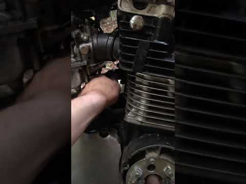

              I was briefly and the noise seemed to stop. Posted a video of me doing that when it was idling.
