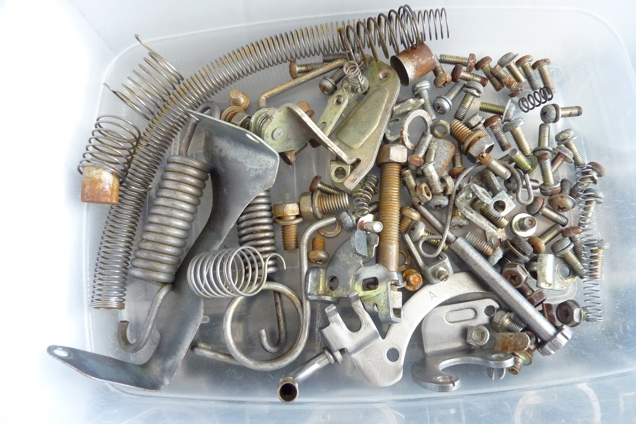

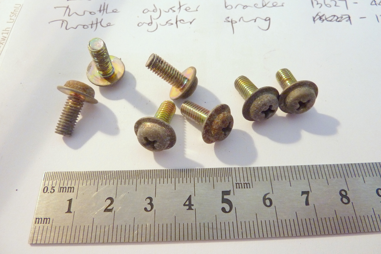

                  If you don't have time, do what I did and just bag them all up and give them to your local plater. I was able to get Cadmium on this lot but it's unlikely that you will find anyone doing it any more:
                  See my blog post on: Plated Carb Parts
                  Before:
                  and after:
                  Before:
                  after:
                  I had a bucket of bits done for about ?30 a couple of years ago. Saves a lot of aggro.
