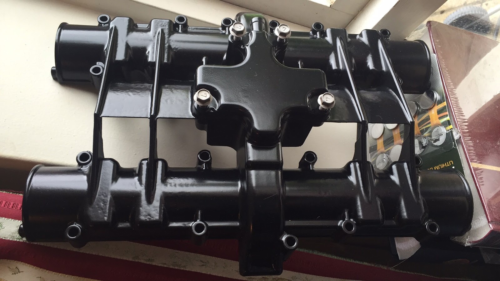

    I painted my engine cover with Dupli-color engine enamel paint. The result looked beautiful.

                Dupli-color engine enamel paint vs. PJ1 engine enamel paint
                Well there is a twist in the plot ....
                After I sprayed my engine head cover with PJ1 black gloss engine enamel paint I ran the procedure below and the paint not only survived but is now hard as a rock and looks beautiful.
                Based on my experiments I can clearly tell that PJ1 is more durable and can withstand 40 minutes of 210C or 410F.
