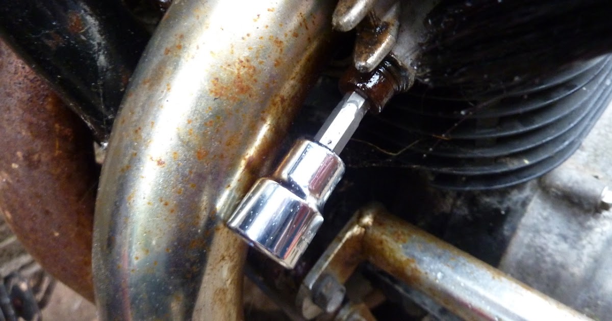

        Hello I have the exact same bike and did have the same problem a few weeks ago. Here we go:

          If your impact driver has the removable tip thatn holds the bits, then just take out the battery and add as many extensions as you need to get to the bolts with the impact outside the box..run the extensions down thru the frame to the bolts. Get rid of the cross tip bolts and add in the stainless allen head style and youll not have the problem again.

                          Just did this yesterday, and some PB and an impact driver do wonders. Let the PB set for a little while, and then give it a go with an impact driver. Be warned though, I ruined the philips head on the impact driver (Thank god for Snap-On's warranty).

                            I used a pair of needle-nosed vice grips. Start with the #4 boot because it's easily reachable with the grips. Use PB Blaster and soak the bolts for a day or two. Grip the rightside #4 boot bolt and work it back and forth slightly to break it loose. The other (left) bolt in the boot can be broken loose by turning the entire boot counterclockwise. Once #4 is out, continue with #3, etc......You'll ruin the bolts, but, they should be replaced with socket heads anyway.
