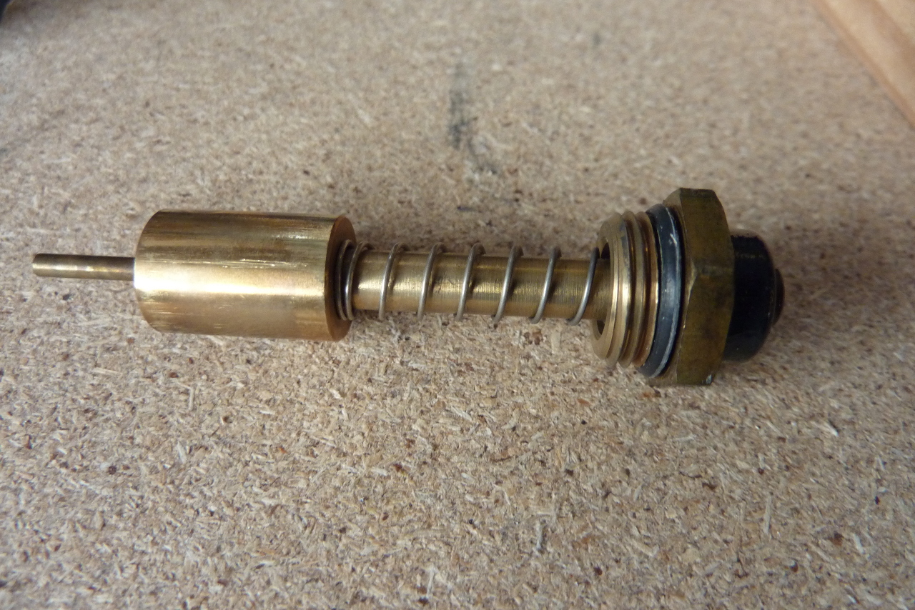

        I had no problem sourcing all the rubber pieces from my local Suzuki dealer (Robinsons in the UK) including both of these chokes pieces:

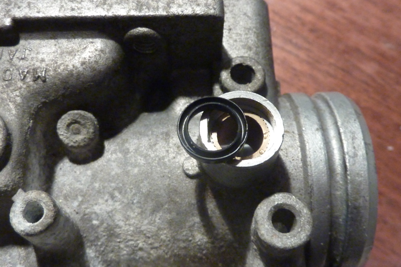

        I also found a seal missing in the butterfly valve rod so I replaced the whole lot:

                  Oh yes I see now. Just looked at my plungers:
                  sorry I haven't got a pic showing the bit you are having a problem with. All my plungers are currently out and they are 30 years old and do not look anything like yours. My rubber internal parts look fresh with no markings and certainly no cracks. If you are in any doubt I would replace the whole piece. I am no expert though. Take advice from others with greater knowledge.
