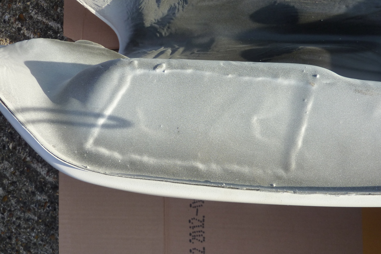

            For instance, I had a radiator refurbishment company cut open my petrol tank underneath. They then shot blasted all the rust out, sealed it, replaced the cut out panel and made good. See my blog posting about the fuel tank:

            I reasoned that there should be no problem doing the same procedure on a muffler. Cut a panel out, shot blast the insides, fix/weld the internal baffles and any other problems and weld it back up and then re-chrome. See my blog posting about that here:
