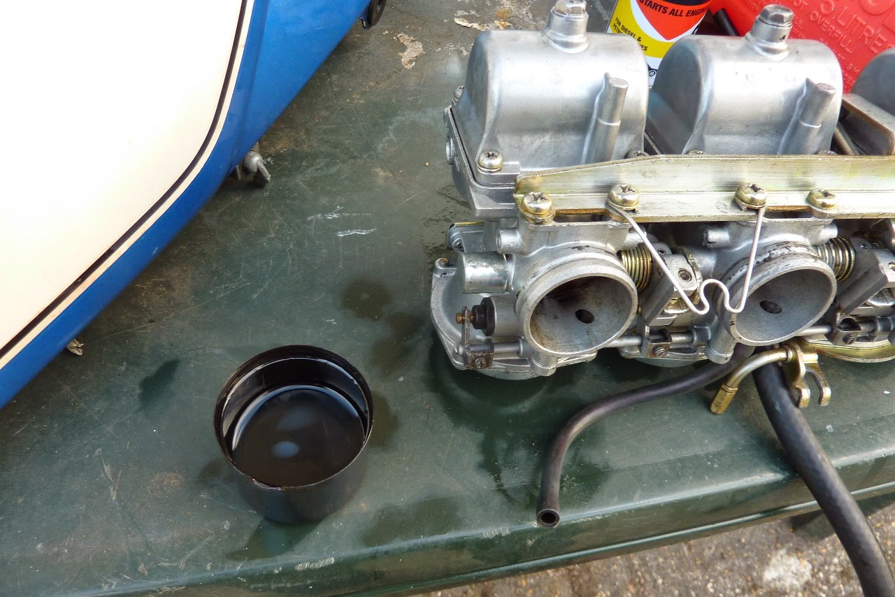

                    I took the carbs off to see what the blazes was going on:
                    All the bowls had a decent amount of fuel in them:
                    Even though little tangs bent quite a bit:
                    There were still within spec:

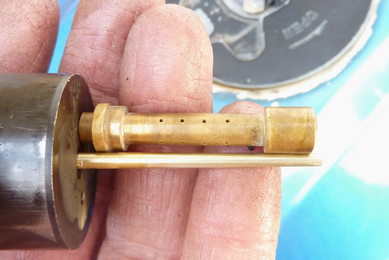

                    Could the needles be a problem? They are quite low in the emulsion tubes:
                    I took the needles out and compared them to another set of carbs I have. This is what I found:
                    All four needles had been assembled with the spring on top rather than under the circlip. I am putting my hand up as being responsible!! I had never taken needles out before this rebuild and they sprung apart on me so I was not able to see the order of the parts. Should have checked the workshop manual. Or had the PO assembled them like that? He just might have ......
