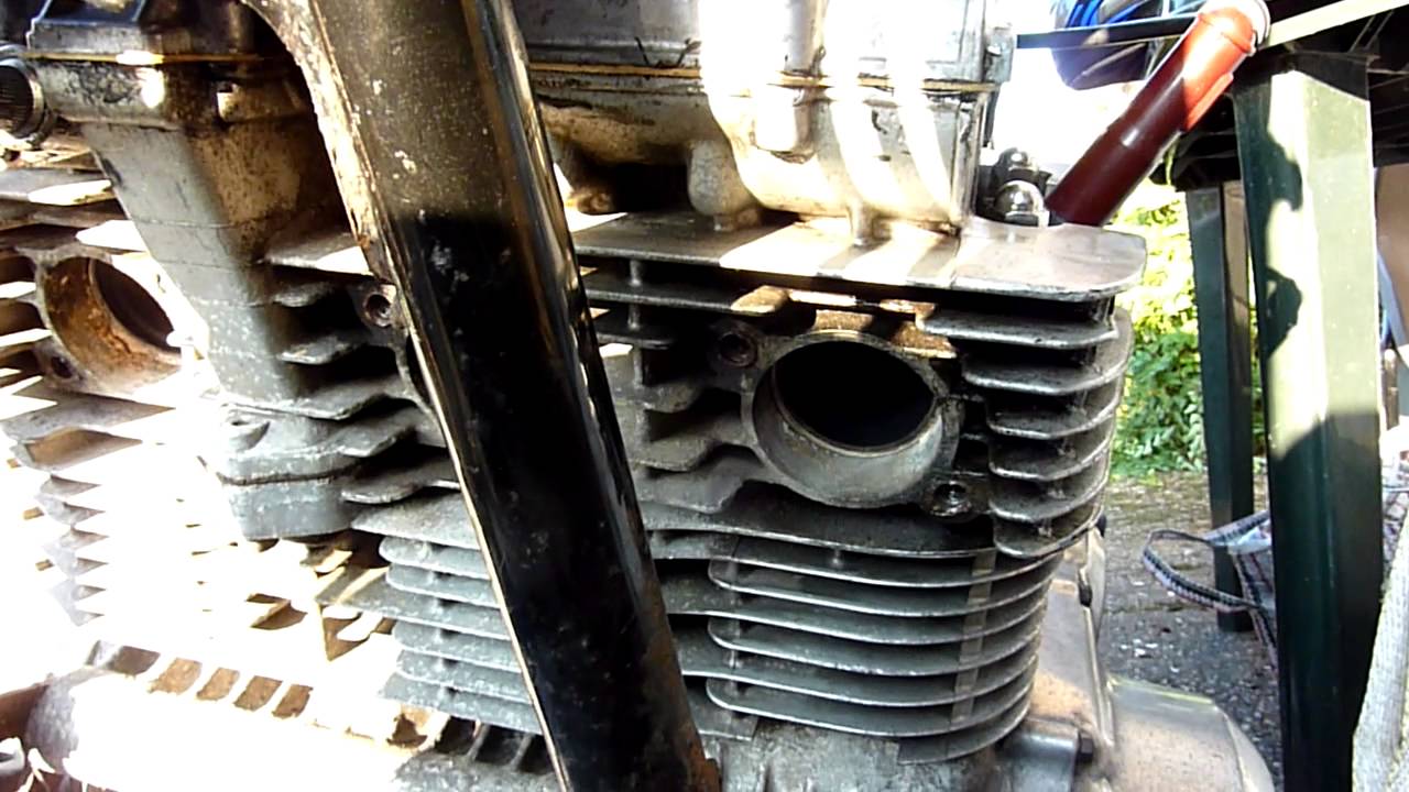

                      Just in case you were still not getting anywhere:
                      I had this problem:
                      It just died when you opened the throttle.
                      It transpired that as soon as the throttle was opened sufficiently to engage the main jets, there was complete fuel starvation. The problem was the needles in the main jets. I had assembled the needles in the throttle slides incorrectly with the spring in the wrong place:
                      This may not be your exact problem but I would suggest a revisit to the throttle slides and needles.
                      Also (and I will be shouted down about this) in my experience of these motors, you should be able to start them up and run them with no airbox and no exhaust pipe. For testing purposes, they will run up throughout the rev range in this condition but obviously not to their full potential. Looking for hairline cracks in the airbox won't provide the answer to why your bike won't spin up. That is my experience.
