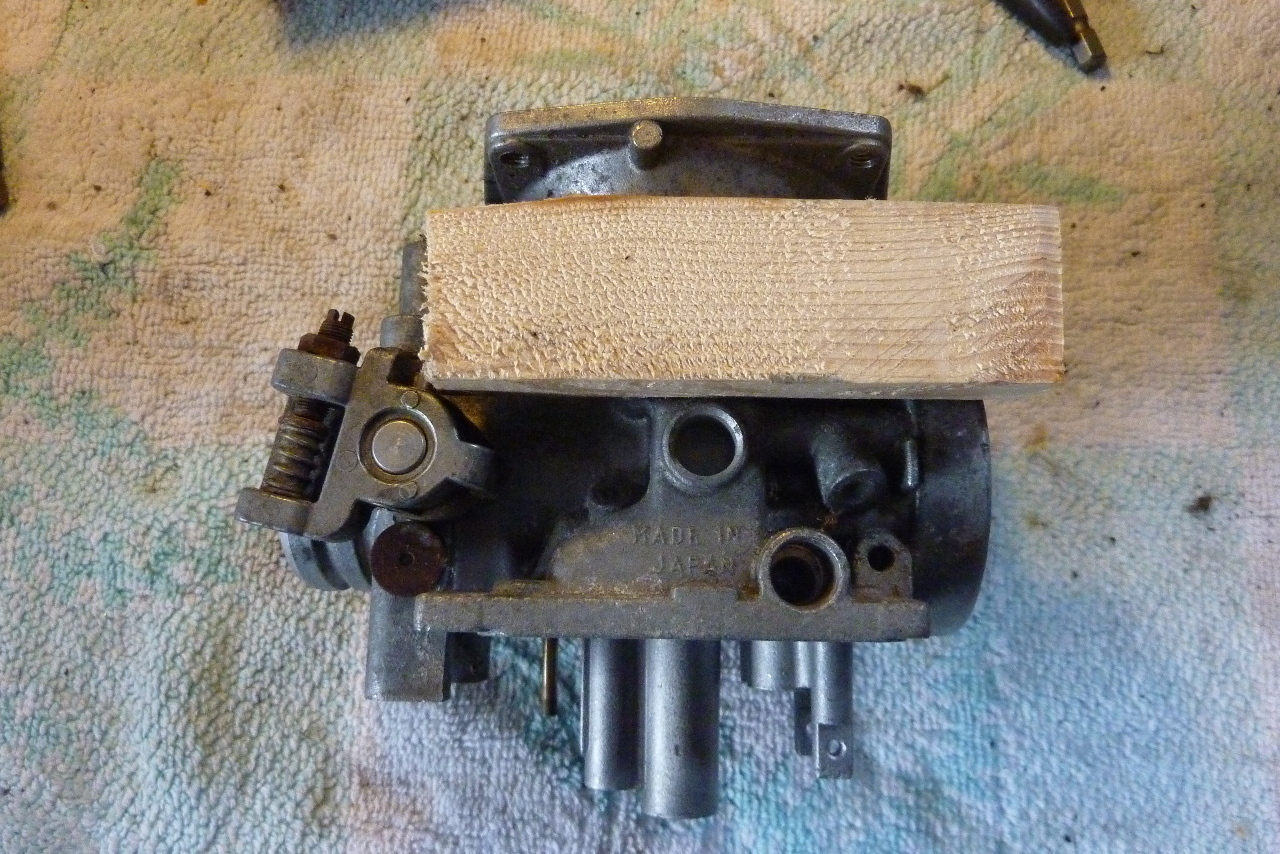

            I know you have the carbs back together again but if you do take them (or any other set) apart, don't be afraid to take the butterflies out. Yes there is a nylon bearing in there but there are also rubber washers that perish or in my case, were absent.
            Here is the nylon washer/bearing and you can see the rubber seal underneath:
            And in one of mine it was missing altogether. Don't know how much difference it made but I was glad to have stripped them right down:
            Getting the butterfly screws out will need the exact JIS screwdriver. Then support the stainless steel throttle rod with a piece of timber:
            Check my GS1100G Resto Blog Dad's Rebuild in my signature for more details.
