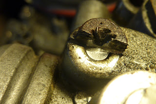

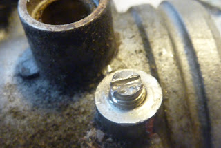

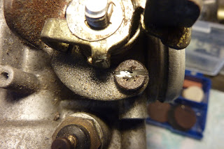

              Heat and cool with a blow torch. Get a punch (flat head) and give it a couple of sharp knocks - to break the thread lock. Cut a slot in it with a hacksaw or a dremel. Apply lots of magic solution (50% brake fluid and 50% cellulose thinners) and allow plenty of time for it to soak in.
              Then this happens:
              So cut another slot:
              And so on. See the whole thread here:
              Carb Screw Problem
              I think you have only just started with this one.
              Good luck.
              Richard
