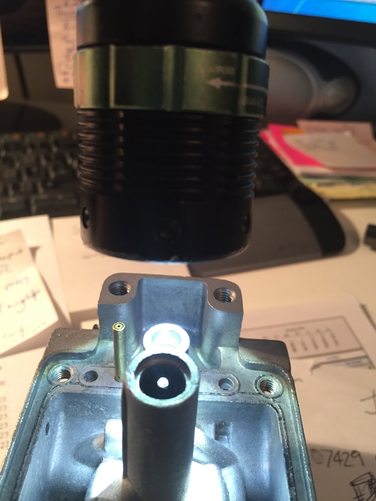

                  Here we go:
                  There is a downward sloping passageway going from the main jet to the pilot jet as shown by the black allen key.
                  If you shine a light into the pilot jet passage you can see the light down the main jet:
                  Another good reason to use an ultrasonic cleaner. How many pepes knew that one was there?
                  The carb bodies themselves are truly works of art. If you look at all the machining holes, plugs and passageways there are. Must have taken lots of man hours to create each one.

                    Thank you Londonboards! It makes perfect sense now as to where the fuel is picked up from for the pilot circuit with that hole capped.
