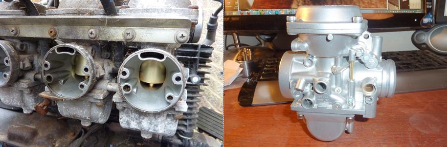

          Getting the butterflies out is what I did, as I had my carbs vapour blasted. I was glad I did it because I found one of the throttle shaft seals was missing from manufacture. Might have caused a little air ingress - who knows.
          However getting the throttles out is not that difficult and I just wanted to do it to be thorough.
          See my blog post: Butterfly Capers
          Here are some pics:
          Vapour blasting did this:
          There used to be a guy on this forum who did amazing carb work. He was called Renobruce or something and he did stuff like this:
          The following thread used to be top notch but now most of the picture links have died (why do people use Photobucket? Google is for ever) but it's still worth a visit:
          http://www.thegsresources.com/_forum...022#post999022
          So I would say try powder coat (they can get it quite thin these days) but take the throttles out.
