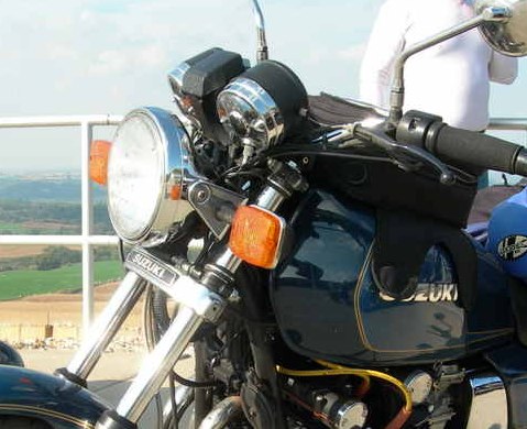

    Just got the Truck-lite delivered today. Having issues with install. Seems the only way I may get it to fit is if I cut off the mounting tabs that the old lens bolted too. Also having an issue with it being a little deeper than the original lens so the birds nest of wiring in the housing assembly is in the way. I will have to clean them up a bit.
    However I'm starting to think it's not meant to fit in my assembly to begin with. I read on a previous post a member mentioned that the Truck-lite does not fit in GL bikes. My bike is a 1982 gs1100 however the title/registration designates it as a GK yet the badging on the bike itself says GL. The bike has been butchered already by a previous owner so I'm not sure what's correct.
    The headlight housing is chrome but has a black retaining ring on the front. I'll post some pictures as well.

      Betcha a dollar that’s not the original headlight bucket. The mounting ears certainly are not. I have read the the L bucket is smaller than the other models. GK would have had a full fairing, maybe a square headlight. Not sure. I think the PO removed the fairing and put on some non-Suzuki GS bucket.
      ok, forget the $1. I just looked at the fiche for the 82 1100GL, that very well could be the bucket you have, and yes, not going to fit the truck-lite, from what I read.

        I'm with him ^^^, the light don't look right & the ears are certainly narrower than the OEM. ears
          I'm looking into replacing the bucket. Found a few I think will work. Z1 has a side mount 7" that is 6-1/4" deep. Should be plenty of room for the rats nest of wiring that's going on inside that I have to clean up.

                OK, we are not going to doubt that you have an 1100, but you are not sure whether it's a G, GL or GK.
                A quick look at the VIN plate on the fork tube should tell, but there are other clues without digging that far.
                Are the front and rear fenders chrome? GL
                Is the front axle below the fork tubes or ahead of them? Ahead = GL
                Is the front fork tube diameter 43mm? GK
                Presuming there is no luggage (saddlebags and trunk) on the rear. Luggage = GK
                It's possible that the GK has been "de-K'd". Look behind the rear footpegs. Is there an extra hole? GK
                There are also extra brackets on the GK frame rails that would hold the mounts for the fairing.
                Those headlight mounts on your bike are definitely not Suzuki. Hard to tell the size of your headlight bucket, but the G would hold a 7" headlight (like your TruckLite), the GL was a smaller chrome bucket that held about a 6" light, the GK had a fairing-mounted rectangular headlight.

                    While you are ordering parts, you should know that you will need new headlight ears, or at least modify the ones you have. When you get your new bucket for the 7" light, your current bracket will be splayed out for the wider bucket. You will at least need to bend the tips so they align with the bucket mounts. If your turn signals mount to the headlight ears, they will now be angled a bit to the sides. You might be able to rotate the ears on the forks and bend them at the forks for the new width to keep the signals pointing forward.

                        My GS850G came to me with a roached Vetter fairing and no headlight parts... anyway, used headlight buckets are ALWAYS rusty and broken, so there's little point in buying used. The G models had black plastic buckets and 7" headlights standard, and the GL/L had the smaller headlights with chrome buckets.
                        I ended up installing a reproduction of a Kawasaki headlight shell that fits any standard 7" sealed beam.
                        Second item on this page, with the 8mm threaded holes:
                        https://newmotorcycleparts.net/elect...ead_light.html
                        I'm sure Dime City/Z1 have the same one. Not sure of the brand; it's been a long time. Emgo, maybe?
                        Works great, just enough room for the rat's nest of wires inside.
