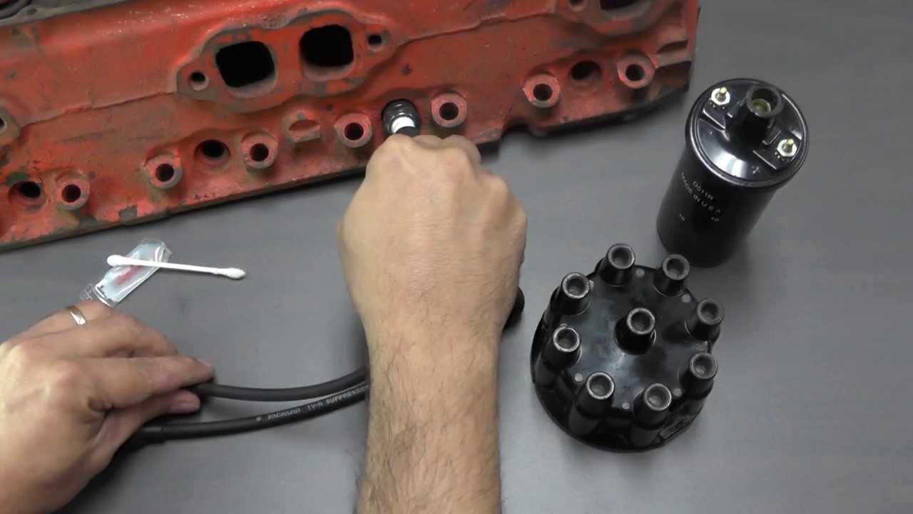

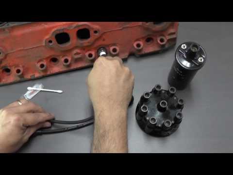

    Bit confused about Dialectric Grease. In this video it says this grease is an INSULATOR not a CONDUCTOR. So why would anyone put it on or around connectors?
    I have just plastered it all over my connectors and now my self-cancelling indicators are not self-cancelling anymore.
    I'm thinking that I have insulated something by using this grease.
