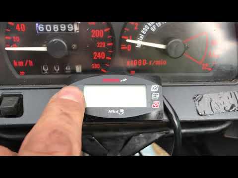

            Just be done with guessing and fit one of these.

                What is the charging voltage at 5000 rpm? That will test the function of the bike's charging system. As far as the battery is concerned, no-load voltage testing (as already mentioned) can lead one to false conclusions. Best to ignore that all together.
